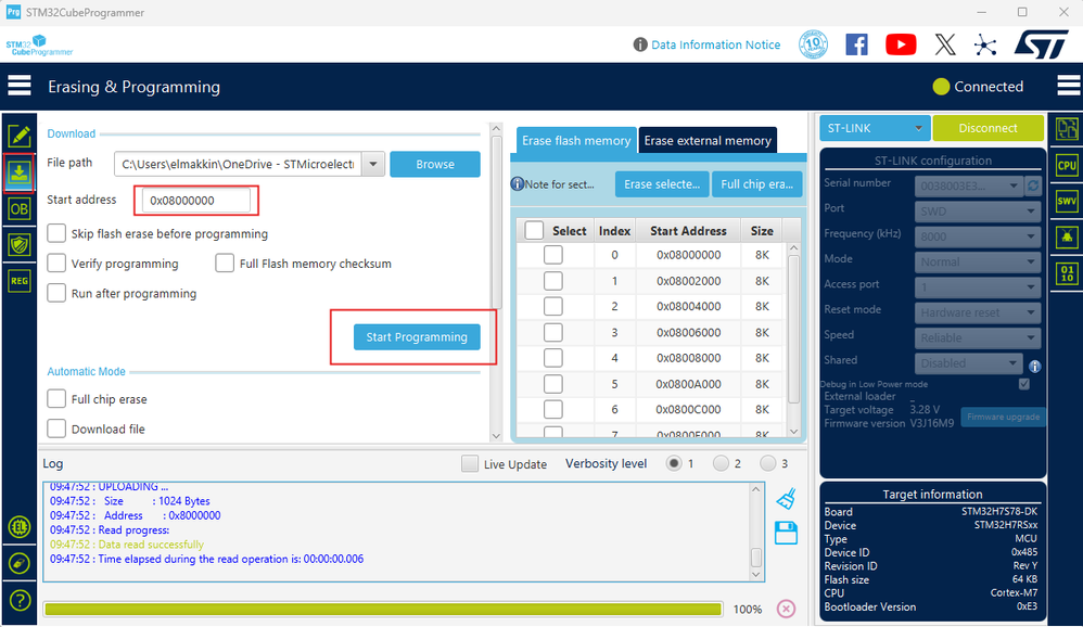

2026-03-15 7:17 PM - edited 2026-03-15 7:18 PM
Thank you for your response; however I am little confused. If I am using the STM32CubeProgrammer to flash, how do I combine step 3, which uses the BOOT_XIP.hex image and link it to MY application code. What is the system flow for flashing the application code using that provided template file.
Does this require me to update certain files from the generated project?
2026-03-23 1:47 AM - edited 2026-03-23 2:00 AM
Hello @msalazar,
Use STM32CubeProgrammer to load the BOOT_XIP.hex (bootloader) into the internal flash at address 0x0800_0000.
