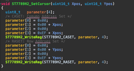

My first test was to get my JPEG and GIF decoders running on an old STM32F723 Discovery board. The built-in LCD didn't work, so I connected an external 280x240 ST7789 LCD to SPI1. Before porting my ST7789 code, I tried to use the library offered by the examples in the latest STM32CubeIDE libraries (st7789h2 written by the MCD Application team). After looking through the code, I noticed some problems in the approach and a noteworthy bug (see below):
First of all, who is the "MCD Application Team"? Are they interested in feedback? Bug fixes? Better code to replace these libraries?
Besides the error above, the overall approach to communication with the LCD is wrong in that it will make every operation much slower than necessary. What's the right approach to share fixes and new code with this community?
