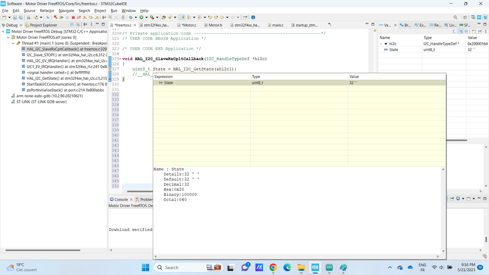

I have developed a code in FreeRTOS mode that contains two main tasks. The first one check if I have received an RX buffer on the I2C bus, and the second one manage the data that has been received.
However, after receiving the first buffer, I am getting HAL_I2C_STATE_BUSY_RX, and I cannot transmit a response to the master device but I'm able to receive another RX buffer . Can anyone please help me?
I'm using I2C in DMA normal mode.
_legacyfs_online_stmicro_images_0693W00000bkVdiQAE.png32-> HAL_I2C_STATE_READY
_legacyfs_online_stmicro_images_0693W00000bkVdJQAU.png34-> HAL_I2C_STATE_BUSY_RX

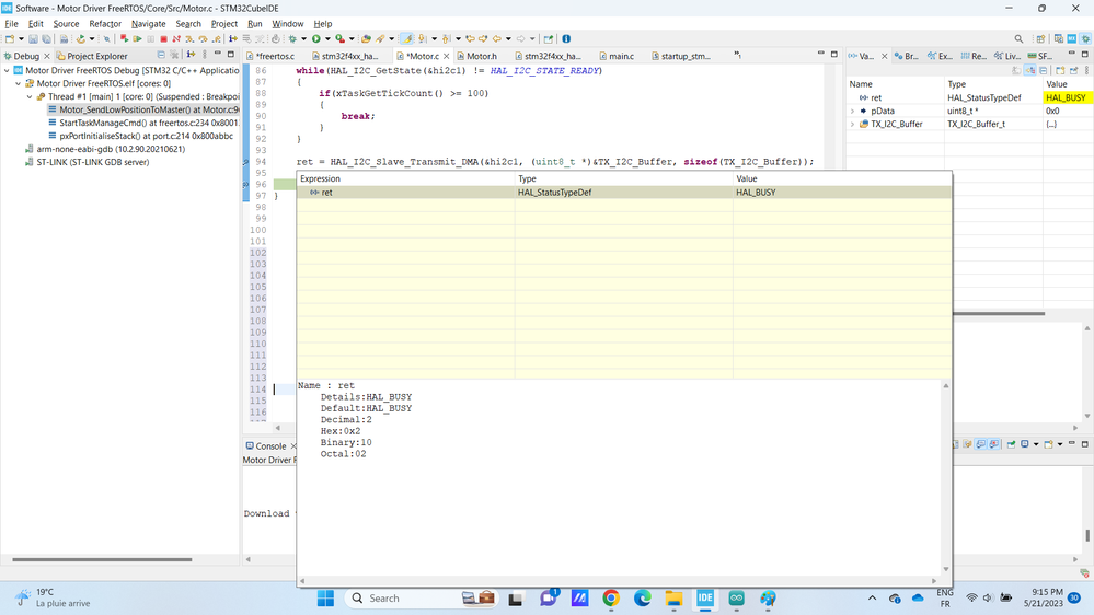

Yes, that's correct. When my code recall HAL_I2C_Receive_DMA() once this function returns HAL_OK indicating that the reception is successful,
I proceed to send a notification to the second task to inform it about the detection of an RX buffer. Subsequently, I transmit this buffer to the second task by a queue.

In the first iteration of my while loop, the code detects an I2C RX bus, but it's not true because I'm not sending anything from the master. After that, if I set a breakpoint on the line ret1 = HAL_I2C_GetState(&hi2c1); , I get ret1 = HAL_I2C_BUSY_RX, but despite that, I am able to receive from other I2C buses, but I'm not able to transmit. This problem occur when I use DMA or IT mode

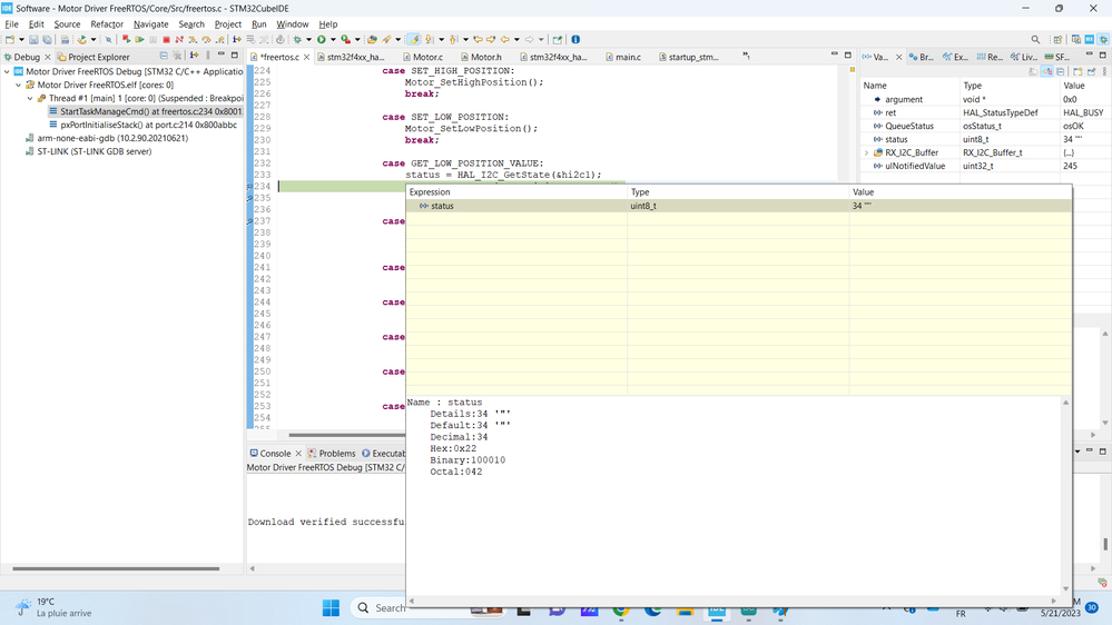

You can't have RX_DMA active and try to transmit. I2C can only do one at a time. Since you are the slave, there should not be any more incoming data until you have sent your response. So don't restart the receive until after you have sent your response.
And a curiosity: why do you use BOTH a queue and task notify? just posting to the queue should be sufficient.

In the first iteration of my while loop, the code detects an I2C RX bus, but it's not true because I'm not sending anything from the master. After that, if I set a breakpoint on the line ret1 = HAL_I2C_GetState(&hi2c1); , I get ret1 = HAL_I2C_BUSY_RX, but despite that, I am able to receive from other I2C buses, but I'm not able to transmit. This problem occur when I use DMA or IT mode.
And if I add the lines of code below I enter in a blocking loop.
while(HAL_I2C_GetState(&hi2c1) != HAL_I2C_STATE_READY)

void HAL_I2C_SlaveRxCpltCallback(I2C_HandleTypeDef *hi2c)
HAL_StatusTypeDef Motor_SendLowPositionToMaster(void)
	HAL_StatusTypeDef ret;
	uint8_t *pData = NULL;
	TX_I2C_Buffer_t TX_I2C_Buffer;
	//pData = FM24W256_ReadMultiByte(LOW_POSITION_1_MEMORY_ADDRESS, 2);
	TX_I2C_Buffer.Addr = I2C_Board_Address;
	TX_I2C_Buffer.I2C_ID = I2C_Slave_TX;
	TX_I2C_Buffer.CmdId = GET_LOW_POSITION_VALUE;
	TX_I2C_Buffer.Data[0] = pData[0];
	TX_I2C_Buffer.Data[1] = pData[1];
	TX_I2C_Buffer.Data[2] = 0xFF;
	TX_I2C_Buffer.Data[3] = 0xFF;
	TX_I2C_Buffer.Data[4] = 0xFF;
		if(xTaskGetTickCount() >= 1000)
			break;
	ret = HAL_I2C_Slave_Transmit_DMA(&hi2c1, (uint8_t *)&TX_I2C_Buffer, sizeof(TX_I2C_Buffer));
	return ret;
Should I stop the DMA receive process before transmitting data to ensure proper operation? If so, how can I accomplish that?
As per both of my most recent posts:
  • Don't rely on HAL I2C states to tell tasks when to run or access the I2C bus. HAL code is NOT thread/RTOS compliant. Use a semaphore, notifications or other RTOS constructs.
  • HAL_I2C_Slave_Receive_DMA() returns immediately, NOT when it has data. See StartTaskI2CCommunication. Use the "rx complete" callback to post data to the queue. Then use "tx complete" callback to notify the other task when it is OK to try receiving again
  • Why are you using BOTH a queue and notifications? One would be sufficient for handling RX data (i.e. the queue).
  • NEW ISSUE: You call to osMessageQueuePut() is wrong. The 3rd param is NOT length, but priority (which is not used). All queue messages are presumed to be the same size - whatever was declared when you created the queue. You declare the queue with "message size"=8 bytes and queue size 1 entry.
There may be other issues that I did not repeat here, or have not yet noticed in your code. Address these issues, then debug your code and trace the flow around the HAL I2C calls.
