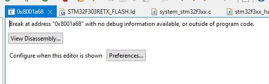

I need to flash on a STM32F303ret6 uC a bootloader and a main Application. Application code works if I flash only this program into the uC, but when I flash both, I always have debug problems and many times the Application doesn't work.
I want to know if CubeIDE messages are "normal" or if I really have a problem.

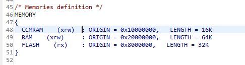

Bootloader has this declaration about memory. Start address is standard, while length is reduced to 32Kb (bootloader is 11Kb).

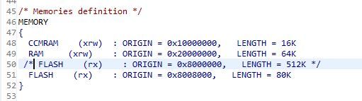

Application
Application's start address is 0x8008000. Application length is 64Kb, so I put a flash length of 80Kb.

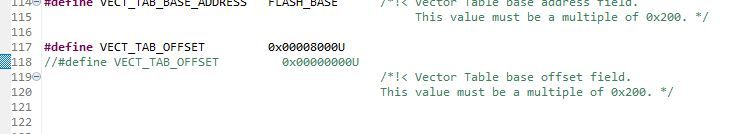

Into the Application code, Vector table is modified to start at the same address 0x8008000.
Then I flash the bootloader code first, and than the Application. While I flash the Application code, I obtained always the following message. I can't understand why.
Is it normal?

Remove the VECTBASE setting from your application (also check/remove it from SystemInit of your app). Make the bootloader set vectbase right before starting the application. Remember to set the stack pointer for the application in the bootloader. In the bootloader, disable all the interrupts before starting the app. Finally, show the corrected code starting your app from the bootloader.

How you While I flash the Application code
From your explain seems you start debug .
Normal way to flash app is use programmer utility...

-> Remove the VECTBASE setting from your application (also check/remove it from SystemInit of your app
But sorry, if I remove these information, how can Application know its starting address?

But always when I flash the Application code I obtain this warning.

Then kill all the breakpoints in the debugger. Looks like there remains an old breakpoit set from some previous version of the project, maybe before you updated the linker script. VECTBASE should be set by the bootloader right before starting the App - that's the most convenient way cause you don't need to remember to change it when you move your app to a different address -> no addresses are hardcoded in the app source, only in a linker script. Of course what you did also may work... sometimes ;)

FYI if yuo set vect in bootloder and jump some init code can change it ... sometimes.
Normal way is set it in app define.

Standart system code @Pavel A.
/* Configure the Vector Table location add offset address ------------------*/
#ifdef
VECT_TAB_SRAM
SCB->VTOR = SRAM_BASE | VECT_TAB_OFFSET; /* Vector Table Relocation in Internal SRAM */
#else
SCB->VTOR = FLASH_BASE | VECT_TAB_OFFSET; /* Vector Table Relocation in Internal FLASH */
#endif
