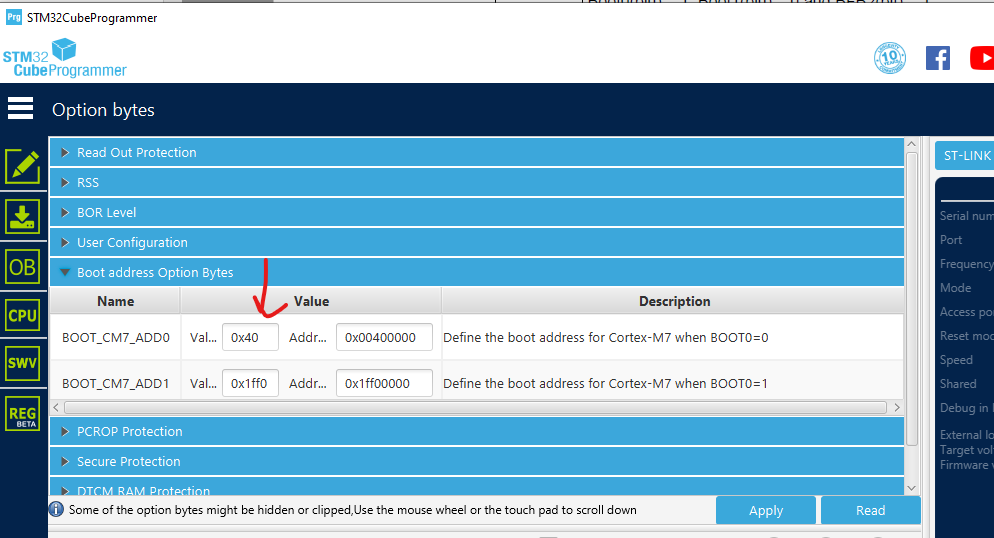

We are using the STM32H753 and cannot enter the bootloader using pattern 8.

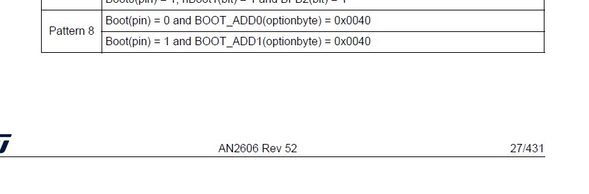

AN2606 states that when BOOT0 is low and the option byte BOOT_ADD0 is 0x0040, then the bootloader is activated.
Does this work for the STM32H753?
Pattern 8
Option byte set to 0x0040 in STM32CubeProgrammer
Thanks for your help!

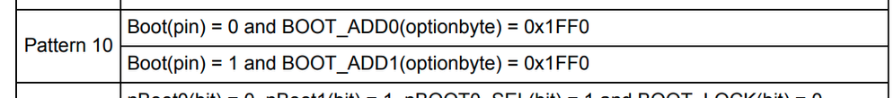

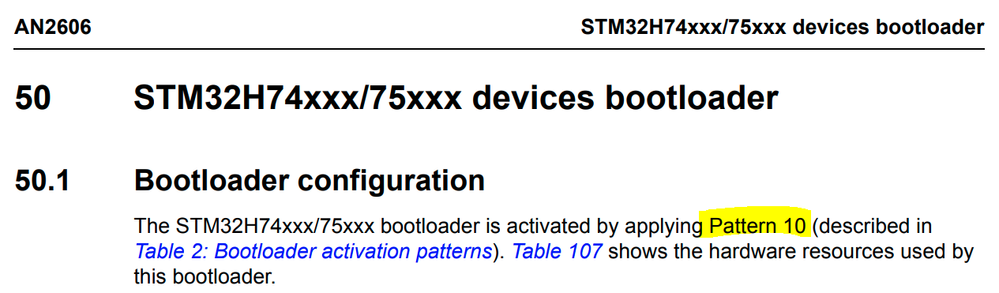

For the H74xxx/75xxx bootloader, AN2606 says the bootloader is activated by pattern 10, not pattern 8.
Pattern 10:
