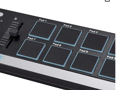

I’m referring to the velocity-sensitive pads used in MIDI instruments, as shown in the image below.

So where did you get that curve from?
Are you creating a new device, or just "hacking" an existing product?
If it's an existing product, can't you just just look at the MIDI output it gives?
@Rider wrote:I don't have any mechanical setup to measure the force applied
Weight is a force ...
But isn't what you're really interested in just the velocity? The actual force is immaterial, surely?
You could measure velocity with a light-gate.
Or drop a known weight from a known height - so velocity can be calculated ...
