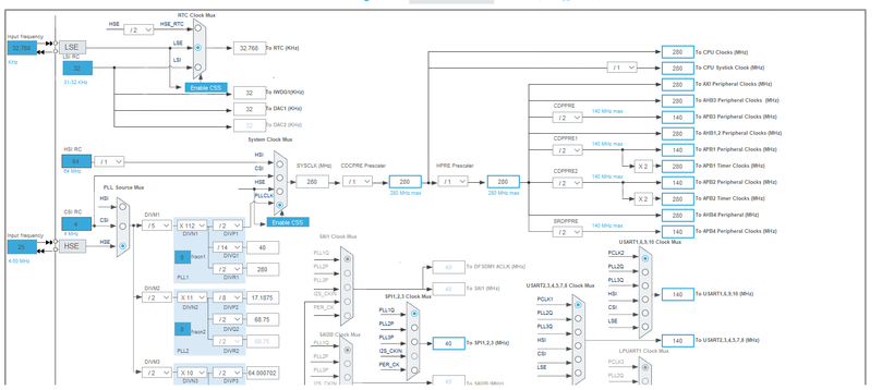

What is your MCU core clock source and rate? Have you used CubeMX/IDE to generate clock setup code?
2024-02-13 9:19 PM
Yes I used CubeIDE. Below is the clock configuration.
