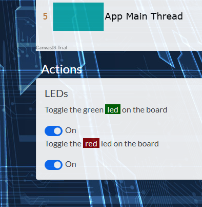

I successfully added controls to enable blinking the red LED controls. I also create a RedLedThred in Nx_WebServer app to blink the red led. Now both LEDs (green+red) can be enabled to blink from website.

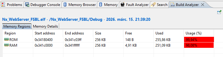

However, the memory usage looks very bad:

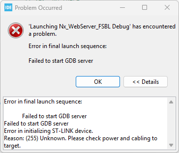

If you set BOOT1 switch to 1-3 (right) position, do run the SingAndLoad.bat, set BOOT1 switch back to 1-2 (left) position, cycle the power then the app runs, but starting the debugger reports Failed to start GDB Server error:
The memory section of the LD file is the factory default:
/* Entry Point */
ENTRY(Reset_Handler)
/* Highest address of the user mode stack */
_estack = ORIGIN(RAM) + LENGTH(RAM); /* end of "RAM" Ram type memory */
_sstack = _estack - _Min_Stack_Size;
_Min_Heap_Size = 0x200; /* required amount of heap */
_Min_Stack_Size = 0x800; /* required amount of stack */
/* Memories definition RAM was originall 256K */
MEMORY
ROM (xrw) : ORIGIN = 0x34180400, LENGTH = 256K
RAM (xrw) : ORIGIN = 0x341C0000, LENGTH = 256K
