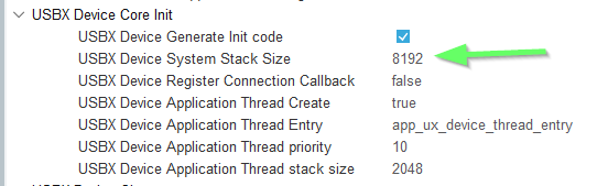

I also found out, that the memory settings in IOC file are too small:
the USBX System stack must be large enough, otherwise the USB Device initialization will fail with insuficient memory.

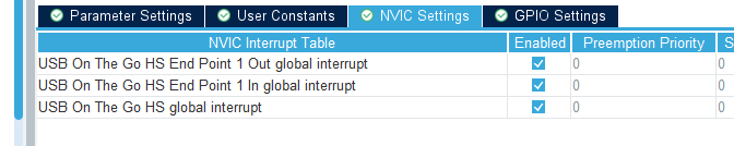

Function call to MX_USB_OTG_HS_PCD_Init should be disabled
and USB interrupts must be enabled

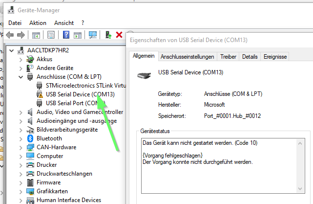

at least, a USB virtual port is displayed on myPC at the moment. But it still has errors. There is still some implementation missing.
"Driver cannot be started"
2023-05-08 5:19 AM
I found the answer for the driver error "cannot start driver code 10"
I needed to change the end point addresses in ux_device_descriptors.h
#define USBD_CDCACM_EPIN_ADDR 0x82U //changed from 0x81
#define USBD_CDCACM_EPOUT_ADDR 0x03U //changed from 0x01I don't understand why this helps.
Can anyone explain?

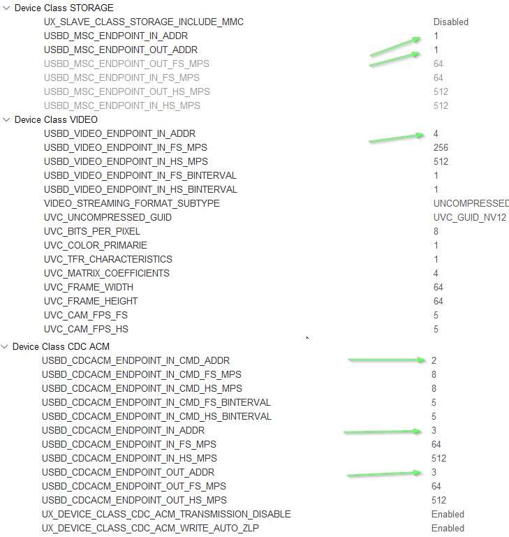

2023-05-11 2:48 AM - edited 2023-11-20 6:21 AM
found the answer myself.
In cubeIDE / cubeMX you have to define the usb endpoint adresses yourself. CubeMX does not do an automatic enumeration .
all endpoints must not overlap.
In-Endpoints are typically 0x80+n and output endpoints are 0x00+n
In and out of one element can have the same number.
In this example
MSC (mass storage) one in and one out (1, 0x81)
CDC-ACM (serial port) uses two endpoint groups
Video uses 4
