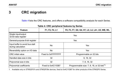

Dear @NimitVachhani ,
This is not possible to use 16-bit CRC on STM32F2 series , they implement our legacy first version with fixed 32-bit Polynomial. Have a look on this Application Note :
Hope it helps you,
