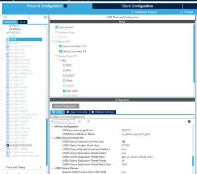

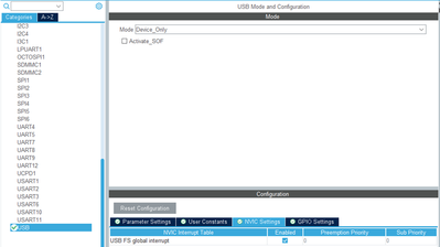

Once the project creation is done, enable the USB peripheral [USB] peripheral in device only mode, located in the [Connectivity] section.

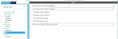

Enable the [CRS SYNC SOURCE USB] option in CRS SYNC, located in the [RCC] section.

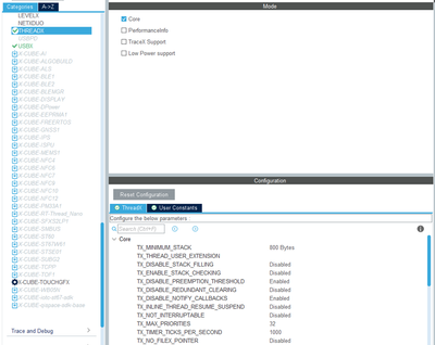

Enable the [CORE] in THREADX, located in the [Middleware and software packages] section.
Increment the [TX_MINIMUM_STACK] to 800 bytes.
Enable the [Core system] [Device CoreStack FS] [Device Controllers FS] [CDC ACM] in USBX, located in the [Middleware and software packages] section.
Change [UXDevice memory pool size] to 12*1024.
Change [USBX Device system Stack size] to 6*1024.

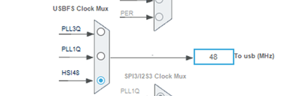

In the [CLOCK CONFIGURATION], just ensure that the USB is getting a 48MHZ signal.

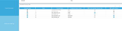

In the project manager, select advanced settings and fill the options like this.
Now, name your project and generate your code.

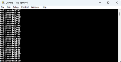

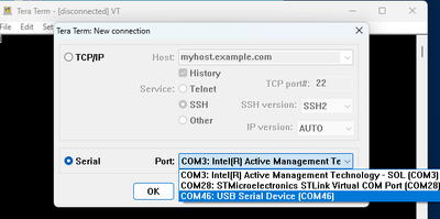

Here all the code implementation is done! You can build and flash the code into your device and try it!
After flashing the code, connect a USB Type-C® cable into the user USB connector and connect it to a computer. Open a virtual COM port terminal in your computer.
An incrementing “Hello world” message must appear in the serial monitor view.

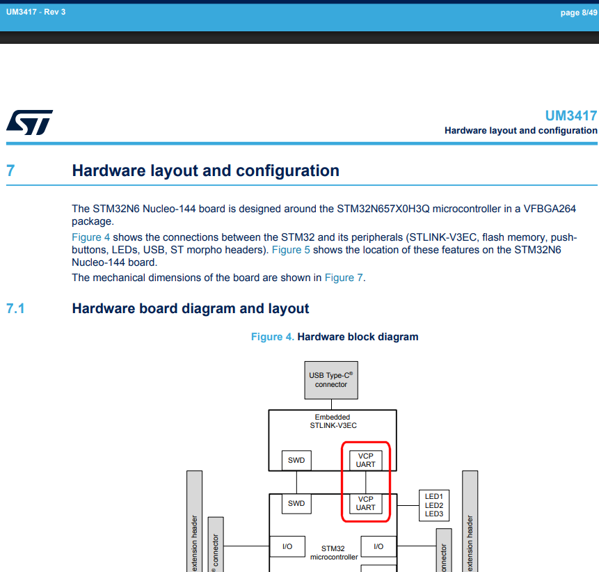

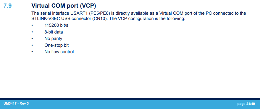

As it's on a Nucleo board, why not just use the Virtual COM Port (VCP) built into the ST-Link ?

@TienNHxz04 wrote:I don't know how to use ST LINK to transfer data to PC
It provides a Virtual COM Port (VCP) connected to one of the UARTs on the Target STM32N657x0q.
It is the simplest way to get data to a PC - no need to mess about with implementing USB and CDC yourself in your code.
Details are in the User Manual for the board:
via: https://www.st.com/en/evaluation-tools/nucleo-n657x0-q.html#documentation
