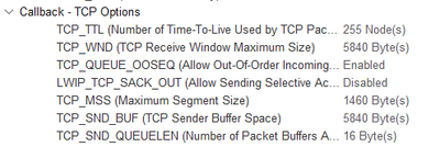

B: LWIP setting:
1. Set IP. The rest Default.
2. Key Option: I followed Adam's setting. I don't understand these here, I just followed Adam (URL above).
Many experts shared to set LwIP heap Pointer address. F767zi does not have that setting available even "show advance parameter" is checked. So I didn't set as shown by Adam's post.

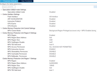

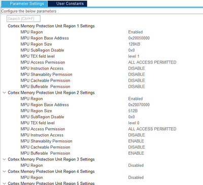

C: Cortex M7 setting
I don't know why these is needed, just follow and adjust linearly from Adam post.

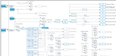

D:Clock to 400MHz
Adam set the SysClk to 400.
I cannot get it to 400 in F767zi, it is RED in the maximum available divider and multiplier.
I tried to maximize it to 200. I wonder if this is critical.
