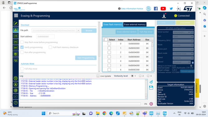

Is it possible to download code to internal as well as external memory at the same time using cube programmer?
If yes, which address should i give as start address?
With cube IDE i am able to download but cube programmer i am seeing the hang like below.
You'd need to split the data into TWO .BIN covering the individual regions which are otherwise a long way apart, resulting in a file that's 2GB in size, and clearly not going to fit within a device with a fraction of that capacity.
A .HEX or .ELF can be sparse
Is there any tool to download .hex file into STM32H5 microcontroller?
