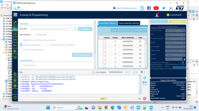

You'd need to split the data into TWO .BIN covering the individual regions which are otherwise a long way apart, resulting in a file that's 2GB in size, and clearly not going to fit within a device with a fraction of that capacity.
A .HEX or .ELF can be sparse

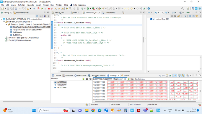

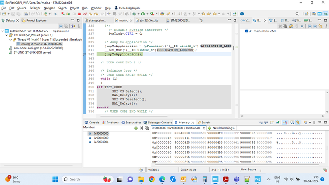

I followed exactly the same instruction given in AN5188 and written Boot and app code like example code you given for STM32H7 only, but when i execute the jumpToApplication(); line, i am always getting Hard fault error.
Before executing jumpToApplication(); line, i am able to see the actual external memory data like below,
After executing jumpToApplication(); line, i am seeing corrupted data in external memory like below, but the data is not corrupted actually.

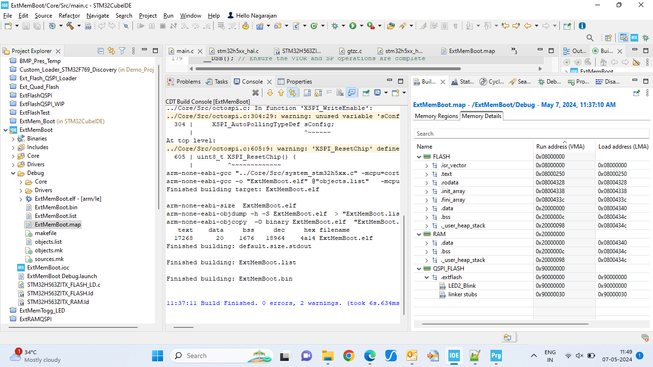

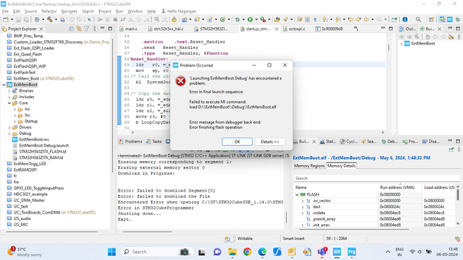

I am able to download the entire code in external QSPI flash with the help of external loader but if i want to keep particular section alone in external memory, i am getting the below error while downloading. Could you please help me to find the reason for this issue. I attached linker script with this chat.
This below variable only i want to move to external memory,
uint8_t buff[10] __attribute__((section(".extflash")));
Note: As i couldnt upload the .ld file directly, i just changed as a .c file.
Use STM32 Cube Programmer, show complete error, ideally with adequate logging to be able to get some clue as to what is happening.
Show whole memory map for the built file, only see internal FLASH addresses in your screen shot
If i download it through cube programmer, it stuck up with the below page itself. it's not even start downloading at all. Attached map and linker file for your reference.
