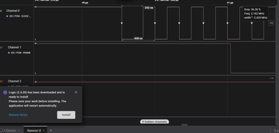

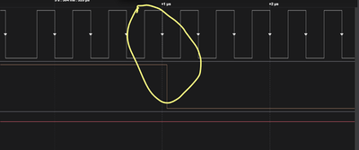

We observed an anomaly in the clock and FSYNC signals. Specifically, the first clock pulse appears wider (duty cycle: 36.36%, frequency: 2.182 MHz, width: 3.429 MHz), while the subsequent clock pulses (duty: 50%, frequency: 3 MHz, width: 6 MHz) behave as expected.
Additionally, we noticed that the FSYNC signal begins in the middle of a clock cycle.
Could you please review this behavior and suggest possible causes?
If this could be contributing to the noisy audio issue, please advise how we can resolve it.
Please refer to the attached images for the observed issue with the FSYNC and clock signals.
Thanks,
Jinal
2025-11-03 11:26 PM
Do you still have 2 SAI slots active? Not good for mono amp.
Also check if you have any uneven clock dividers.
