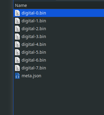

I captured the output waveform from both the TAS2110EVM (with XMOS MCU) and the STM32 setup, and I noticed that the waveforms are different. Could you please review the attached waveforms and help identify the possible cause of this issue?
PFA the waveform captures from both MCUs.

2025-10-14 8:47 AM
What is this ?
Show a png or jpeg - if you want, i can see it.
2025-10-14 9:36 AM
Hi @AScha.3 ,
I’ve shared the .sal files, which can be opened using a logic analyzer.
I’ll also share waveform snapshots for your reference.
Thanks,
Jinal

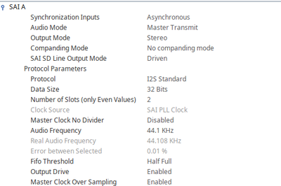

so adjust the clock for SAI to 256 or 512 x Fs ; ...until "real" matches (close) the desired Fs;
see on my H743 clock tree:
+ adjust settings, as i wrote ->
a: adjust the TAS2110 to I2S standard , stereo
or
b: adjust on STM something similar to PCM for DSP, Ti format (afair).

>the ratio is set to 256 with an SCLK of 12 MHz
Thats not important, to have 256; you need to set, what the SAI needs, with your setting. (Fs, bits/frame, etc.)
As seen in my last post, i set it to 256x Fs, to get 44,1k .
And 12M is no audio clock, maybe 12.288 M , is 256 x 48k Fs.
So first decide, what you want : 48k or 44k1 .
What all this should be ? A digital amp (TASxxx) with input from...PC ? or what else ?
