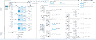

2025-09-30 11:20 AM
Hi @Saket_Om
Thanks for your response. My clock configuration is shown in the image, and I’ve attached the IOC file for reference. Appreciate your support!
Thanks,
Jinal

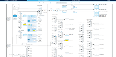

2025-10-01 3:10 AM
Hello @Jinal
Could you try with the flowing config please.
In this config the SAI kernel clock is around 11.294 which is nearly multiple of 44.1 Khz.

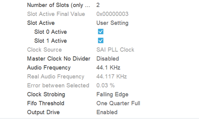

2025-10-07 7:14 AM - edited 2025-10-07 7:15 AM
Hi @Saket_Om
Thanks for response,
I configured the SAI kernel clock as per your suggestion, and the audio output is now slightly clearer.
When we play a mono-converted audio file using the existing configuration, the sound quality has improved — it’s more audible, though still not perfect.
Could you please suggest the recommended configuration for mono audio playback?

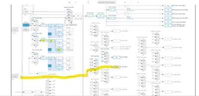

Hello @Jinal
The ideal is to use an external SAI clock with an output frequency exactly multiple of 44.1 Khz.
2025-10-08 12:20 AM
As per your suggestion, we made the changes and the clock now appears almost the same. However, the audio is still noisy.
Could you please suggest the correct mono mode configuration so that we can test the mono audio file with it?
