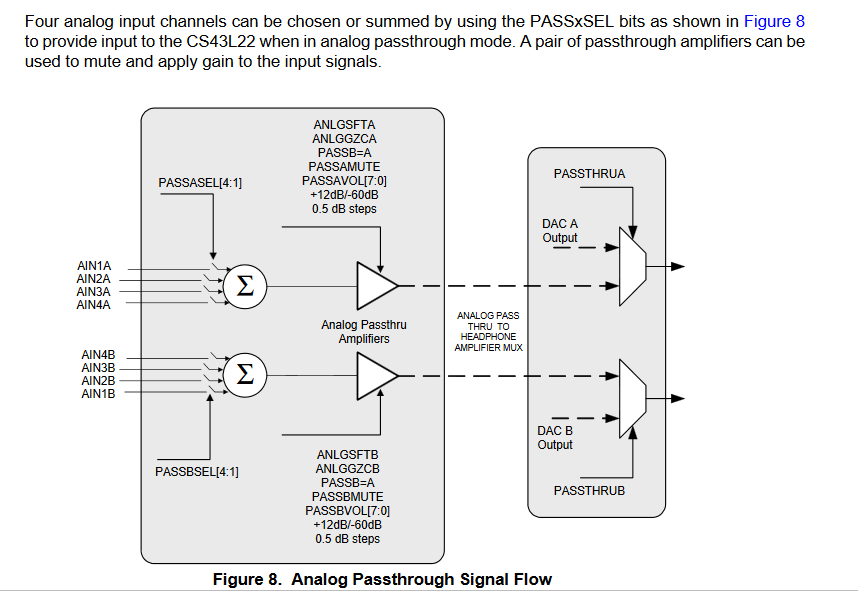

Is the correct AnalogIN input selected?
If for example you have selected the input from PDM_OUT, you hear the digital ''noise'' of microphone.
If you have selected the input from DAC_OUT...Make a test , configure the DAC_OUT PA4 as GPIO PP output in low state. Observe for noise. If noise exists the CS43L22 is not correctly intialized or has some HW malfunction.

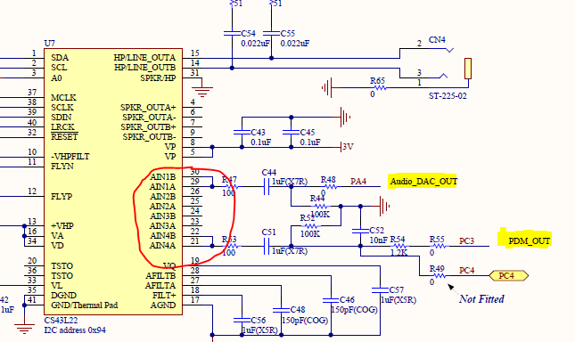

I'm taking input from an external analog mic. The flow is Mic -> ADC -> DAC -> Codec
You mean you have noise without some input signal ?
-In the above flow, even if I don't give any input to ADC, there is some noise. (Some frequency components-4kHz, 4.5kHz, 16kHz).
-Yes. I'm using AIN1A, AIN1B.
Selected input is DAC_OUT.
If noise exists the CS43L22 is not correctly initialized
- Can you help with initialization?
