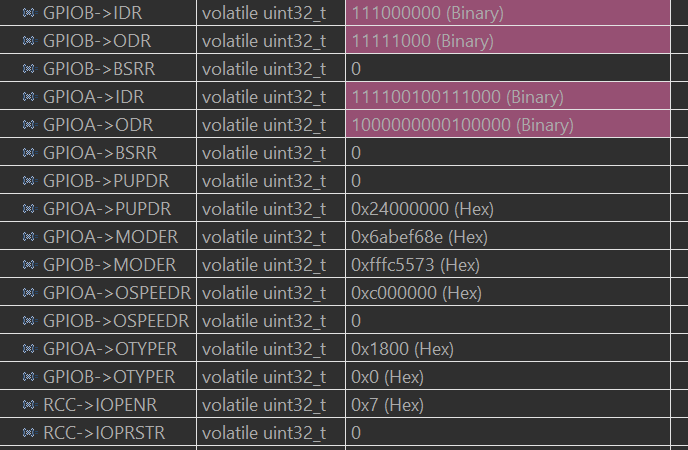

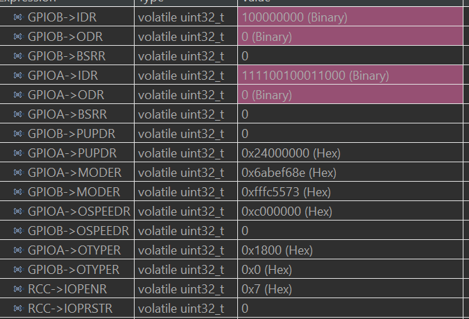

Now PB4, PB5, PB5, PA5, and PA15 are floating, configured as output, low speed, pushpull and no pullup/pulldown resistor. The very basic output configuration.
ODR react perfectly at my command, I tried using ODR register and BSSR register as well. In both cases, ORD toggle also the way I want. I just dont have voltage on certain of my output pin, as IDR shows below. I also checked every pin that I could put as output, they are all working perfetcly fine but the one I said and also PB1 that have the same problem. In the picture and code below, I just show the main output that i'm interessed in, not all of them.
So to resume :
PB1, PB3, PB4, PB5, PB6 and PA15 are uncontrollable (ODR = 1, IDR = 0) as a basic output push pull no drain, pin not connected to anything.

I even manually put 3,3V on all the problematic GPIO to check if IDR would change.
It does work for all the pins but the one that have a problem already, so it doesn't seems to be a configuration problem but a STM32 problem. I cannot provide a good big zoom on the STM32 soldering.
