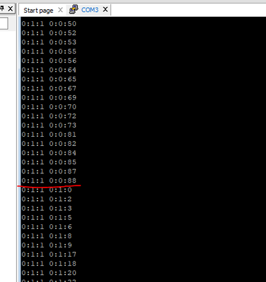

2025-06-18 9:05 PM
Hi @TDK, I’ve modified my code based on your suggestion. The time is now incrementing, but I’ve noticed that the minutes increase when the seconds reach 89. Ideally, the minutes should increment when the seconds reach 59. I’ve attached the modified code and the output file for your reference.

2025-06-18 10:49 PM
You read time/date as BCD, i.e. 9 seconds is 0x09, 10 seconds is 0x10 = 17 - note the 9-to-17 transition in your printout; similarly 58 seconds is 0x58=88 (osDelay() plus the printing code results in slightly more than 1sec of delay between RTC readouts).
You want to use the binary readout facilities of Cube/HAL.
