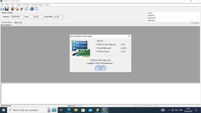

Kindly provide me the latest Firmware version for the above-mentioned Product along with the necessary instruction to upload it using STM32 ST Link Utility.
We are currently getting old firmware issues screenshot attached
Please assist us regarding this at high priority.

2024-04-22 12:54 AM
STM32L152 Nucleo-64
STM32 ST-Link Utility.exe V3.8.0
ST Link USB Driver.dll v4.4.0.0
ST Link_CL.exe v2.4.0
