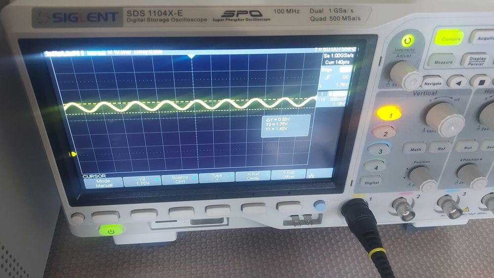

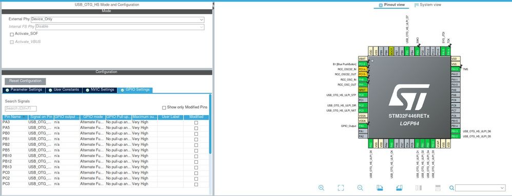

I have checked that there is no activity on DIR, STP, NXT, and Data pins of ULPI.
I am getting the Clock signal of 60MHz from the USB3300 Chip but it's not the proper squarewave. When I connect it on the PC the USB Device is detected but with an error of no descriptor found.
There is nowhere mentioned how the data will be written to ULPI Pins.
PFA of Clock signal and CubeMx.
2024-03-21 3:01 AM
Hello @YashJ
It seems like the issue is more likely linked to transceiver. According to ULPI spec, the clock direction can be reversed, the link can provide the 60MHz as an input to the PHY. The crystal pins can be removed from the PHY.
Duty cycle must always be within 5% if the 4-bit bus implementation option is used.
Could you check VDD? It should be in range [2.7V, 3.6V] with CL = 20 pF

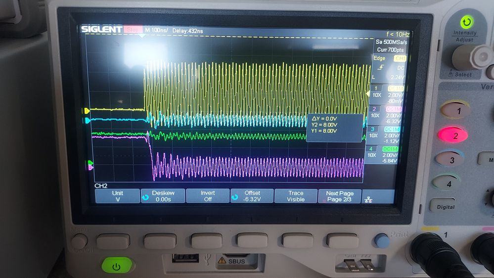

2024-03-22 12:06 AM
Hello @FBL
According to the datasheet of USB3300, the CLK pin is only an Output pin. The Vdd voltage is 3.3v.
I have attached the waveforms of CLK(Yellow), DIR(Purple), NXT(Blue), STP(Green). This time I used a 10x probe and my scope is 100MHz. Here before CLK the state of DIR is High and after CLK the state of DIR is Low, but the state of STP is the same HIGH as it should also go Low after the DIR pin goes Low according to the document ULPI Design Guide https://ww1.microchip.com/downloads/en/AppNotes/en562704.pdf.
If I disconnect the CLK Pin my code hangs on line 33 while loop:-WaveForms

2024-03-22 3:06 AM - edited 2024-03-22 3:10 AM
Hello @YashJ
First let me thank you for the effort and details. Indeed, the USB3300 does not support using an external 60MHz clock input.
According to design guide, section 5 Timing and Protocol, it is mentioned: ULPI interface can accept external 60MHz clock. Also, see 5.1.2 ULPI Input Clock Mode. You may need to consider this to select your PHY.
The second point, based on the waveform, I guess it is confirmed that CLK is not operating accurately. You can measure duty cycle and oscillation frequency drift PPM .. Link cannot drive low STP.
Finally, once you disconnect CLK pin, the code is expected to hang because core will no longer receive the CLK signal it needs to operate and without that clock the hardware cannot perform any operations including CRST.
2024-03-22 4:29 AM
Hello @FBL
I couldnt understand how clock is not operating accurately. I took measurements of clock it is 60MHz and with nearly 50% duty cycle. As my oscilloscope bandwidht is 100MHz it can't measure accurately.
So, what is the option now?
