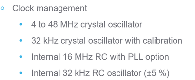

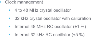

You can miss many thinks, but primary read first carefuly about mcus.
C011
G030
no PLL vs PLL usw.
