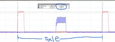

I'm working on optimizing SPI communication on an STM device, and I'm encountering an issue with the timing of SCLK pulses. After transmitting 16 SCLK pulses, there's a delay of 3μs before the next set of 16 pulses can be generated.
I need to reduce this delay to ensure that SCLK can be immediately generated after CS goes low. Can anyone suggest methods or configurations to minimize this delay and maintain a continuous SCLK stream after CS is pulled low?
I'm trying to achieve sampling rate for ADC ADS7046 interfacing.
sclk take same time even not used CS.
I want to sclk immediately on after cs low.
Below I attach some snap of spi cycle.
