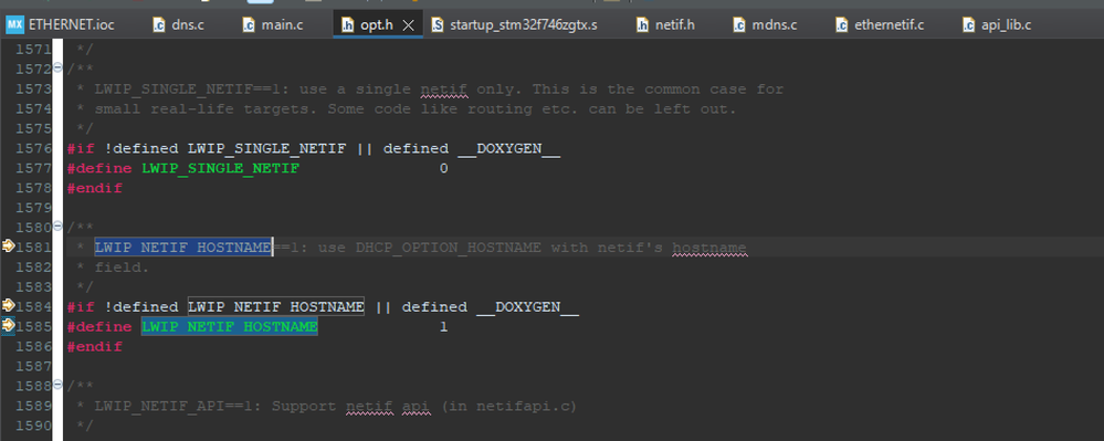

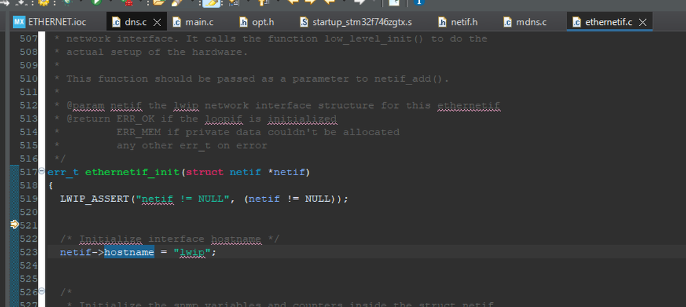

I realize that in STM32CubeMX generated lwipopts.h #define LWIP_NETIF_HOSTNAME is set to my_lwip by default but I change this to 1 manually. Otherwise, in ethernetif.c, the statement netif ->hostname - "my_lwip" is not enabled.

I could ping my device via the IP attained through DHCP but not through hostname. Looks like the default is set as "lwipW . I tried to ping lwip and lwip.local
I also override the
Attached my ethernet.ioc in case if you take a look and help me please.
