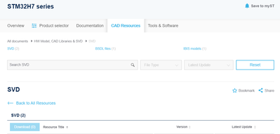

You can find latest updates of SVD files on st.com under STM32xx series > CAD Resources > SVD.
for example, for STM32H7 series, you find the package under https://www.st.com/en/microcontrollers-microprocessors/stm32h7-series.html#cad-resources:
These SVD files should be aligned with RM, but if you still note some discrepancies, please report them here in the community in separate threads.
We continuously consider reported issues regarding SVD files to maintain the packages.
