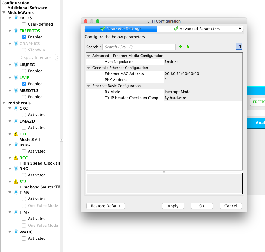

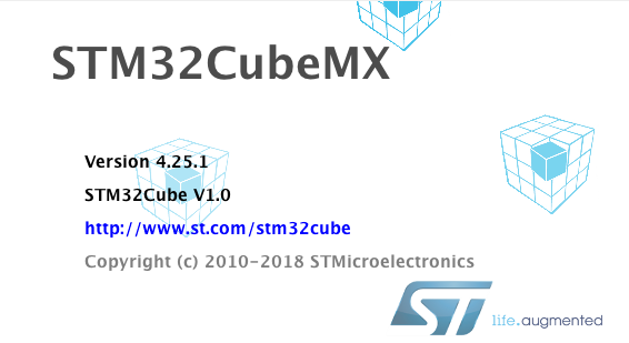

2018-05-23 6:37 AM
It is NOT fixed in 4.25.1. PHY defaults to 1 - see attached images
2018-05-23 7:06 AM
Hello
doe.john.016
,B
y default,
the PHY address value in ETH configuration is setted to 1, and you can change it to 0.
