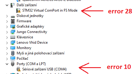

Final problem is some on both examples:
0693W00000AMurAQAT.pngTested on 3 computers with win10. With and without installed STM vcp drivers and all results is identical as this image.

As I've said, USB is not simple.
The best thing to do is to observe enumeration and subsequent requests on the bus, using a dedicated USB bus analyzer, or some of the LA/oscilloscopes which support USB protocol decoding (e.g. the Asix LA offerings).
Do you have implemented the SendEncapsulatedCommand and GetEncapsulatedResponse requests, required as per USB CDC PSTN subclass, for Abstract Control Model? If yes, continue debugging by observing all unhandled class-specific requests which may arrive from the host.

Hi PHude.1,
The support of the VCP interface is managed through the ST Virtual COM Port driver available for download from www.st.com. Please make sure that you are using this driver.
