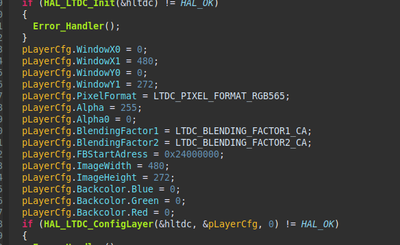

2025-12-10 8:03 PM
This is my linker script and i declared my framebuffer like this in main.c file
__attribute__((section(".framebuffer"),aligned(32))) uint16_t framebuffer[LCD_WIDTH * LCD_HEIGHT];
lv_color_t lvgl_buf[LCD_WIDTH * LVGL_BUF_SIZE];this is it nothing else i done for frmabuffer. and inside the LTDC i gave the RAM start address
pLayerCfg.FBStartAdress = 0x24000000;
