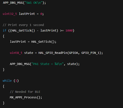

Here is the code snippet:
APP_DBG_MSG("SW1 OK\n");
uint32_t lastPrint = 0; // Print every 1 second
if ((HAL_GetTick() - lastPrint) >= 1000)
lastPrint = HAL_GetTick();
uint8_t state = HAL_GPIO_ReadPin(GPIOA, GPIO_PIN_1);
APP_DBG_MSG("PA1 State = %d\n", state);
while (1) { // Needed for BLE MX_APPE_Process(); }The output I get is:

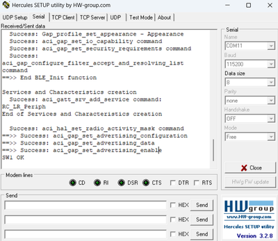

SW1 OKAfter that, I never see “PA1 State = …”.
No further serial output.
I tried placing the print inside the while loop and outside the loop, but still no data in the serial monitor.

The code does not enter the if condition, which is why the pin state is not printed.

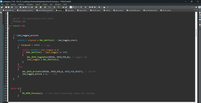

my code

I understand why the if() is not entering, but my question is:
How can I run this function (LED toggle logic) without using while() or if() inside the main loop?
I want the LED toggle to work automatically when the button callback sets led_toggle_active = 1, but the BLE example uses:
Since everything must run inside the BLE scheduler, I am not sure what is the correct method to schedule or run my LED toggle function without adding blocking code or polling inside the while(1) loop.
Should this be implemented using:
UTIL_SEQ_SetTask() or
a timer callback
or some other recommended method?
Please advise on the proper way to execute such logic in STM32WB without adding if() checks inside the main loop.
