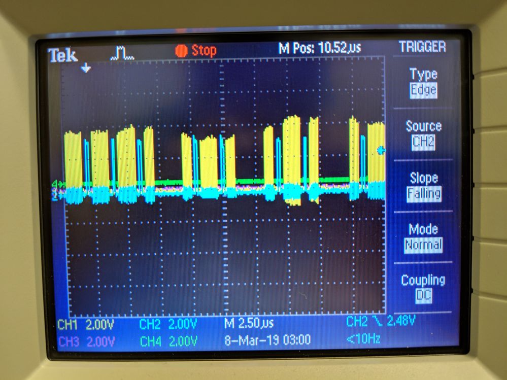

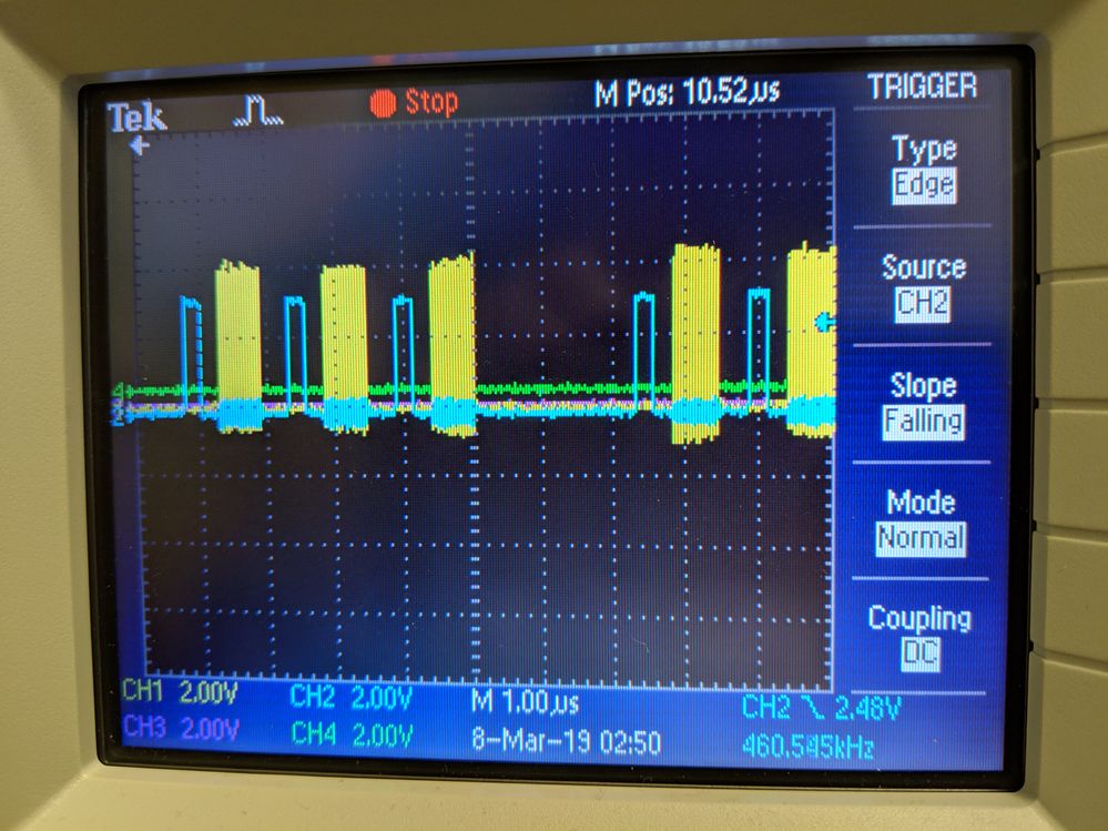

I end up with a 2.5 us delay after 3 transmissions. Don't worry about the signal level of the clock looking weird, I'm using a probe with a long grounding lead that's coupling to a lot of noise.
I ran into this problem originally when I tried hiding the latency of two consecutive transactions by sending two transmissions and then gathering the data afterward.

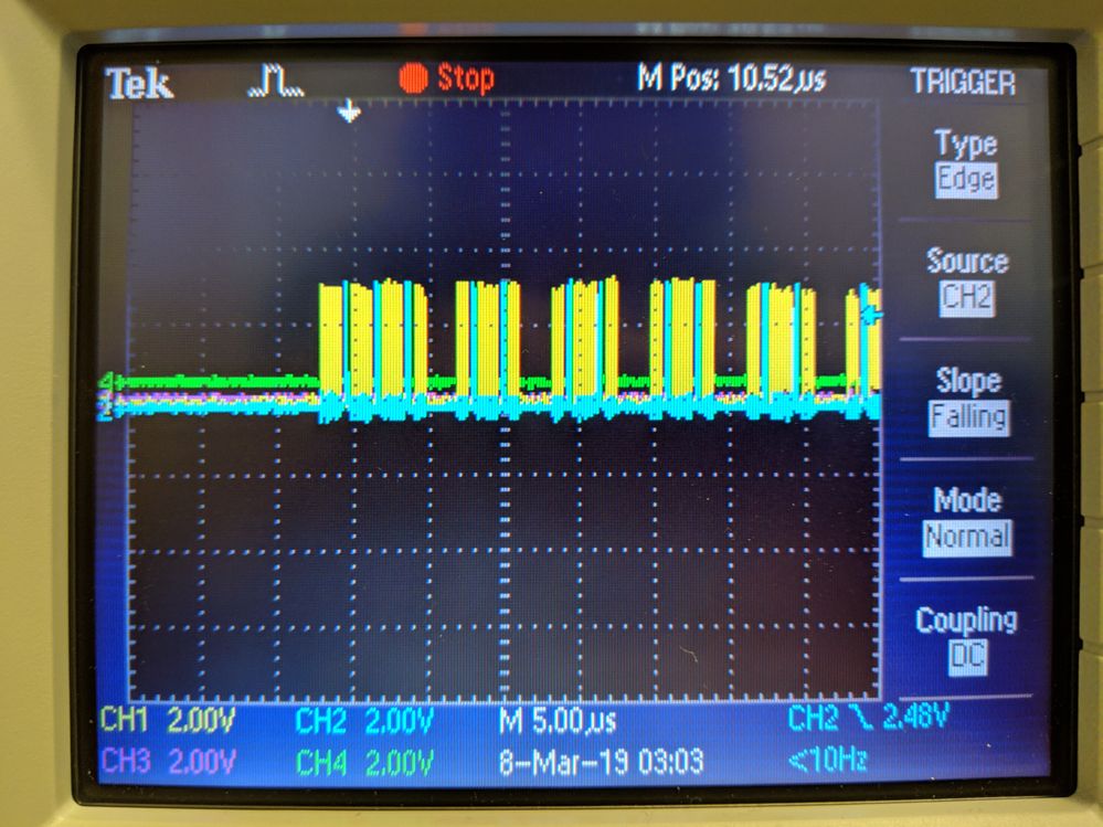

}This results in a delay between the two data transmissions being long after every other transmission after the first 4. This significantly reduces the timing slack to pick up the first data word before it gets overwritten. In addition it modulates the sampling rate of the SPI peripheral, which I wanted to be a deterministic and stable as possible.

In the first test, where you sent/received one 16-bit value at a time, maybe you could toggle another GPIO in the while() loop waiting for the RXNE flag. Or pulse a GPIO after you have read the RX data. That will tell you if the delay that you see from the SPI clock burst to the rising edge of the chip select is due to some (unexplained) delay in RX data available, or somewhere else.
The image from the first test also looks suspicious regarding the duration of the clock burst. In the first test, the time scale is 1us/div, and the duration looks to be around 3/5 of a division, or 0.8us. In the second test the time scale is 2.5us/div, and what I presume is the full 16-bit clock burst is about 3/5 of one division which about 1.5us. With PCLK1 = 25MHz and SPI prescaler DIV2 I would expect around 1.3us for the 16-bit clock burst. So the 2nd image makes sense. Did you change SPI clock frequencies between these tests?
2019-03-08 2:58 PM
Double checking I realized that the SPI bus is clocked by PCLKL2, which was set to 50 Mhz. The clock period is 40 ns for all traces, so a 16 bit transaction would be about 700 us. In the second example I was attempting 2 16 bit SPI transactions back to back so that is why most transactions look like they are about 1.4 us. However every third trace splits those two transactions. Good point on using more gpio for debug. I'll give that a try.
