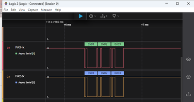

I have checked it using logic analyzer, the transmitted bits show up. I'll attach the ss below. I'm transmitting txdata = [0x1, 0x2, 0x3] .......
As it is loopback the same thing comes in receive but I couldn't see anything in receive buffer.

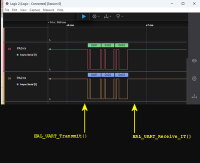

HAL_UART_Receive_IT(&huart2, buffer, 1);HAL_UART_Transmit does not return until the transmission is finished;
You only call HAL_UART_Receive_IT after that - when the transmission is finished and gone!
2025-01-27 2:47 AM - edited 2025-01-27 2:47 AM
Sorry, just to understand more clearly so, u meant when transmission is happening only receiving also is happening at same time but I'm calling receive function after transmission so that is the reason no data is coming in receive buffer, is it?
2025-01-27 2:58 AM - edited 2025-01-27 2:59 AM
@Meghana wrote:u meant when transmission is happening only receiving also is happening at same time
Not in the way you've coded it.
Again, HAL_UART_Transmit does not return until the transmission is finished.
@Meghana wrote:I'm calling receive function after transmission so that is the reason no data is coming in receive buffer, is it?
Probably; or, at least, the reason you're not getting an interrupt.
