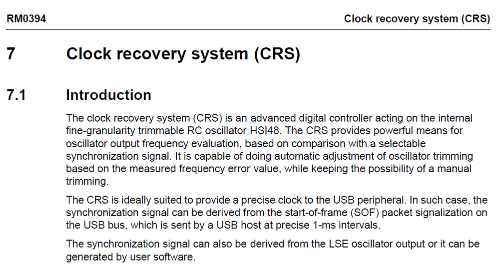

The L4 has a clock recovery system. If you use that, you can use USB without a crystal. The MSI by itself is not accurate enough.
Not the 'L476, though.

Can you explain how to use the clock recovery system?

Does the L496 have a clock recovery system? If so, can you explain how it would be used? Considering switching chips from the L476 to the L496.

Or would the HSI48 be accurate for the application as specified above?
