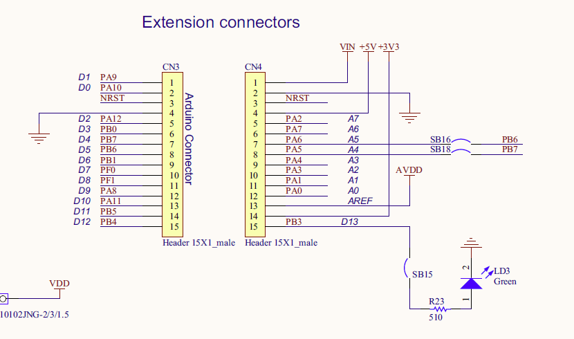

That was a typical RTFM problem... there is a solder bridge between PA6 and PB6 on the Nucleo-L432KC. Shit. :)
(can be found in the Nucleo-32 user manual UM1956)
