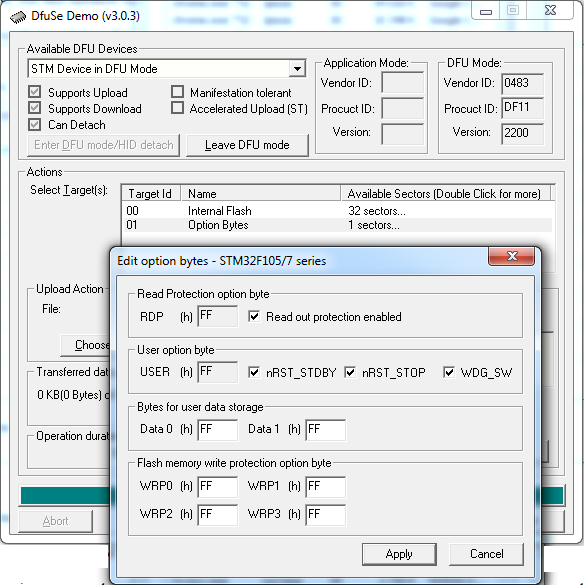

Denis
, howare you erasing your flash memory from user code? I prepared code witch execute from SRAM, but this mechanismnot stable, sometimes MCU requiredhardware restart for detecting in Dfu. I found solution with using ''Option Bytes'', 100% work solution!void
GoToBootloader()
FLASH_OBProgramInitTypeDef OBParam;
HAL_FLASHEx_OBGetConfig(&OBParam);
OBParam.OptionType = OPTIONBYTE_USER;
/*Reset NBOOT0 and BOOT_SEL, see: RM 2.5 Boot configuration*/
OBParam.USERConfig = 0x77;
//Sorry for magic number :)
HAL_FLASH_Unlock();
HAL_FLASH_OB_Unlock();
HAL_FLASHEx_OBErase();
HAL_FLASHEx_OBProgram(&OBParam);
HAL_FLASH_OB_Lock();
HAL_FLASH_Lock();
HAL_FLASH_OB_Launch();
Now CPU alway detected in Dfu after reboot, for switch CPU to normal mode you should restore ''Option bytes'' after flashing new firmware.
1. Use DfuSe
