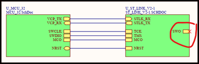

Yes... that simple. Maybe because the MCU has too few pins.
2025-05-30 7:29 AM
@CTapp.1 wrote:I though that's what it used to program the target device?
SWDIO & SWCLK are used for programming and debugging.
But this thread is about using the ITM Trace output, which goes via SWO - an extra pin!

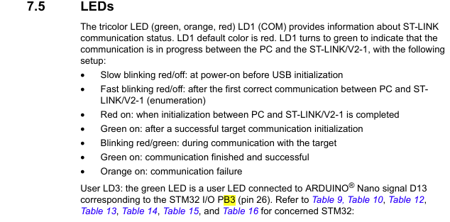

@Pavel A. wrote:Yes... that simple. Maybe because the MCU has too few pins.
I don't think it is because the MCU has too few pins, because SWO is available on pin PB3.
