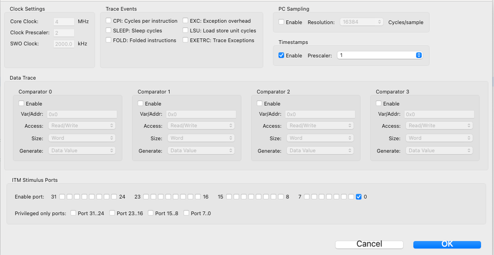

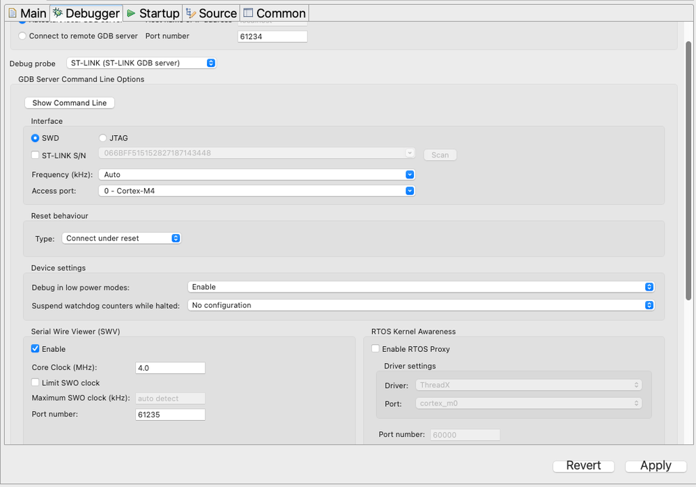

}I didn't make any changes to the Clock and as far as I know the default clock for STM32L432 is 4MHz. Here is the debug and ITM configuration:
I also started recording in ITM Data Console window.
I don't see any traces in the SWV ITM Data Console window. Any ideas why? What am I doing wrong?
