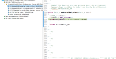

I'm working on a project using the STM32H750B-DK board with TouchGFX and FreeRTOS. The application gets stuck in this loop:
while ((HAL_GetTick() - tickstart) < Delay) {}
I debugged and confirmed that HAL_GetTick() is not incrementing
