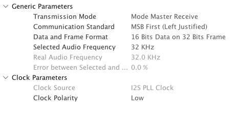

I have some trouble setting up the correct acquisition of the MEMS microphone over I2S.
Consider the STM32F401RE Nucleo board connected to the IMP34DT05 PDM microphone with L/R to GND.
Through Mx, the I2S peripheral is configured as follows:

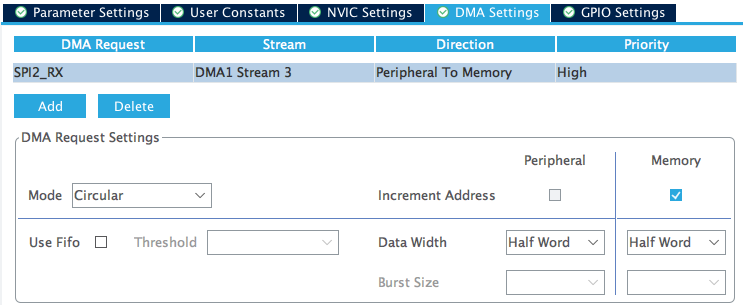

Then, the DMA is configured as a circular buffer, half-word:

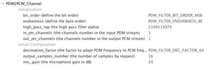

Finally, I have configured the PDM2PCM library as follows:
Starting from that configuration I'm having trouble understanding why the PDM2PCM is not working as expected.

Having configured the DMA as a circular buffer, I would expect that at every interrupt Half of the buffer is filled with new data, while the other half is used to run the PDM_Filter function and complete the PCM conversion and copy the data out to the pcm_data.

Now I have 16kHz selected audio frequency, 16-bit data on 16 data frame, 64 decimation. Therefore the I2S clock should be 1.024MHz.
I record the audio of a pure tone (e.g. 500Hz) and then I convert it to a 16bit, 16kHz .wav file. The problem is that the recorded audio, played has double the frequency of the pure tone (1000Hz in this case). How could it be possible?
Changing the data and dataframe format to 24-bit in 32 data frame solves this issue.
But I don't undestand why!
Why with 16-bit data the pure tone appears with a double frequency?
Do you have any suggestions?

I'm using the internal HSI (16MHz) to derive the clock (M=10), the PLLI2S is configured with N=192, R = 5 that resulting in 61.44MHz as I2S clock. This is fine with the documentation (Tab.10 AN5027) for mono configuration.
Changing the data size: 24bits on 32bit frame requires that the pdm_buffer[128], but the call to:
HAL_I2S_Receive_DMA(&hi2s2, &pdm_buffer[0], 128/2);
Requires that only half of the size is passed to the DMA because internally one left shift is done for data with 24 and 32bits.
This configuration perfectly works.
However, simply changing the data size: 16bits on 16bit (or 16bits on 32 bits) frame requires to call:
HAL_I2S_Receive_DMA(&hi2s2, &pdm_buffer[0], 128);
Passing the full size of the buffer.
However, this solution results in a distorted audio signal.
Looking with the debugger, the I2SDIV and ODD are the following:
The resulting Fs for both configuration are correct.
Could you help me understand? Have the pdm_buffer the wrong size?
Thanks!

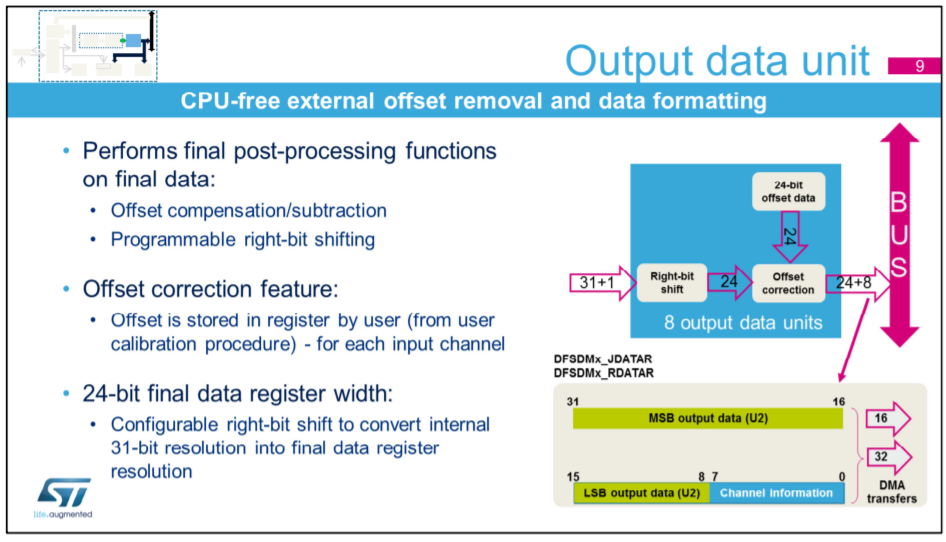

I got this feedback from our experts: they are referring to the X-CUBE-MEMSMIC1 library, and they are asking you whether you are using this function pack.
If so, the I2S peripheral configuration in the MEMSMIC1 with the PDMFilter function works (only) if it is set in that way (i.e. 24 bit on 32).
This because, during the data conversion, registers of specific 24-bits peripherals are used, together with local variable at 32 bits.
For this reason, if you change just a configuration parameter in the I2S configuration, then the procedure works no more.
See for example this presentation --> STM32H7-Peripheral-Digital Filter for SD Modulators interface (DFSDM)In any case, during the conversion the "useful" data have an extension of 24 or 32 bits, never at 16 bits.
