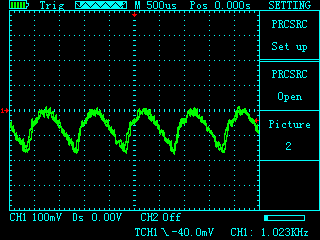

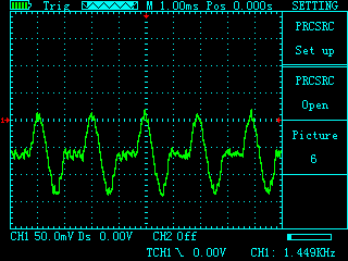

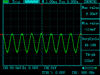

I am programming an SMT32F69I-DISCO board to output a SINE wave. I am having trouble with the Size parameter of the BSP_AUDIO_OUT_Play() function. I have a buffer of 100 that I am filling with my SINE values:
int16_t dataI2S[100];
Here are my calls of the functions to initialize and play audio @48 KHz:
BSP_AUDIO_OUT_Init(OUTPUT_DEVICE_BOTH, 80, 48);
BSP_AUDIO_OUT_Play(dataI2S, (uint32_t)200);
Here is what it looks like when I put 128 as the Size parameter:
When I set it to 100:
When I set to 200:
According to the function definition I put below, it sounds like it should be set to 200 because it's the size in bytes.

2021-11-23 5:11 AM
The period is consistent for each data length. How do you know the data you're sending isn't what is displayed? How are you initializing the array?
2021-11-24 4:09 AM
Yes, it seems that I only have 64 values in my array, not 100! Can't believe I did not catch that. Thank you!
