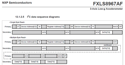

I am working with STM32CubeIDE, trying to connect a Nucleo-L4R5ZI board to an ADCS chip using I2C. The method of communication is very strange, requiring: [start condition] - [controller sends two bytes] - [start condition] - [controller sends one byte] - [controller reads several bytes] - [stop condition].

An actual part number would help to check the datasheet.
But from the images, it looks like you can use HAL_I2C_Mem_Read_IT
2024-03-12 7:45 PM
Doesn't this code send more than is specified in the datasheet? It sends buf and then read_buf, but the datasheet only says to send TLM ID, presumably only a single byte.
Regardless, this is a common interface for reading/writing registers over I2C. HAL has this implemented in HAL_I2C_Mem_Read, including IT and DMA variants.

That's good to know... but in this case, the "Device Address" (0xAE the first time, and 0xAF the second time) is not the same as the actual device address (0x57). Does that change the function I need to use?
2024-03-13 9:17 AM - edited 2024-03-13 9:26 AM
The Slave Address is 0x57 - it is 7 bits.
0xAE is a byte value with the Slave Address (0x57) in its top 7 bits, and its LSB (the R/W bit) set to 0;
0xAF is a byte value with the Slave Address (0x57) in its top 7 bits, and its LSB (the R/W bit) set to 1.
So, yes - they are all the same Slave Address.

2024-03-13 9:25 AM
Thank you very much! This is definitely the key observation I was missing.
