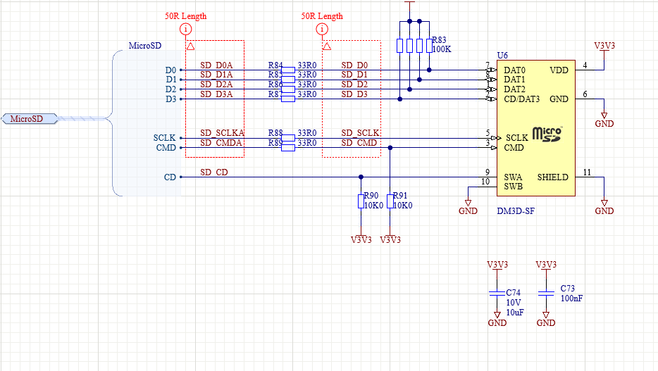

schematic of the SD card adaptor:I configured the following in CUBEMX:

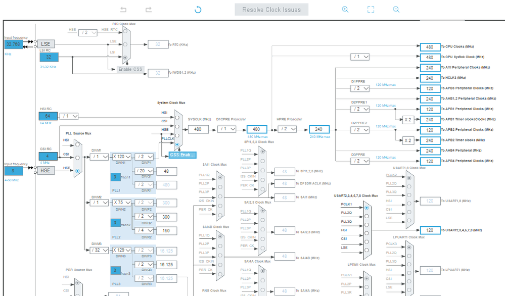

My clock config:When i run the following code :

When i test the signal on the oscilloscope i notice that:
From the start of the f_mkfs function the CLK is always 400KHz, even if i change the clockvalues
CD responds with short HIGH signal.
All data busses are completely empty, (no data)
I added a zip file of my fully configured SD test program.

2.
set port pin pullups and speed to medium ;
