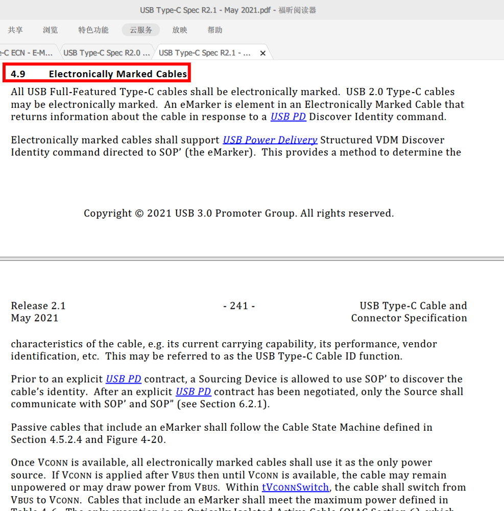

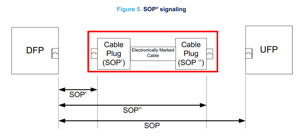

You mean this: https://www.pshinecable.com/article/What-is-an-E-mark-chip.html ?
2022-07-25 7:27 PM
Yes, Emark communicates with the host via SOP‘.
