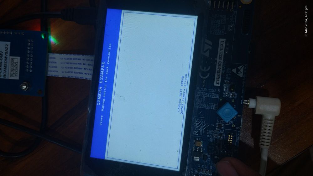

While testing drivers using example BSP from STM32H747-DISCO, everything works fine, but the camera example triggered with a camera init error. Any suggestions will be appreciated.

Hello @PavanKaruchola1 ,
I think you face the same issue as reported here.
I tested the BSP example available in STM32Cube_FW_H7_V1.11.2 version and I didn't encounter any problem.
The "CAMERA INIT ERROR" issue can be can happen if the camera is not detected. It might be due either to a wrong connection or a malfunction of the camera board.
I advise you to plug and unplug the camera board while the board is not powered. A short-circuit can happen otherwise.
Could you please try with another B-CAMS-OMV camera board?
I hope this help you!
Kaouthar

2024-04-17 2:29 AM
Hi @PavanKaruchola1 ,
Any update about this issue?
If you need further clarification or support, please do not hesitate to share it :).
Thank you.
Kaouthar.
