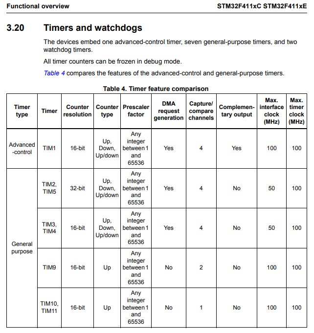

@Kai_Satone wrote:STM32f411CEU6 ... there is no pin LPTIM1 in the section of TIMERS.
That chip doesn't have an LPTIM1 timer:

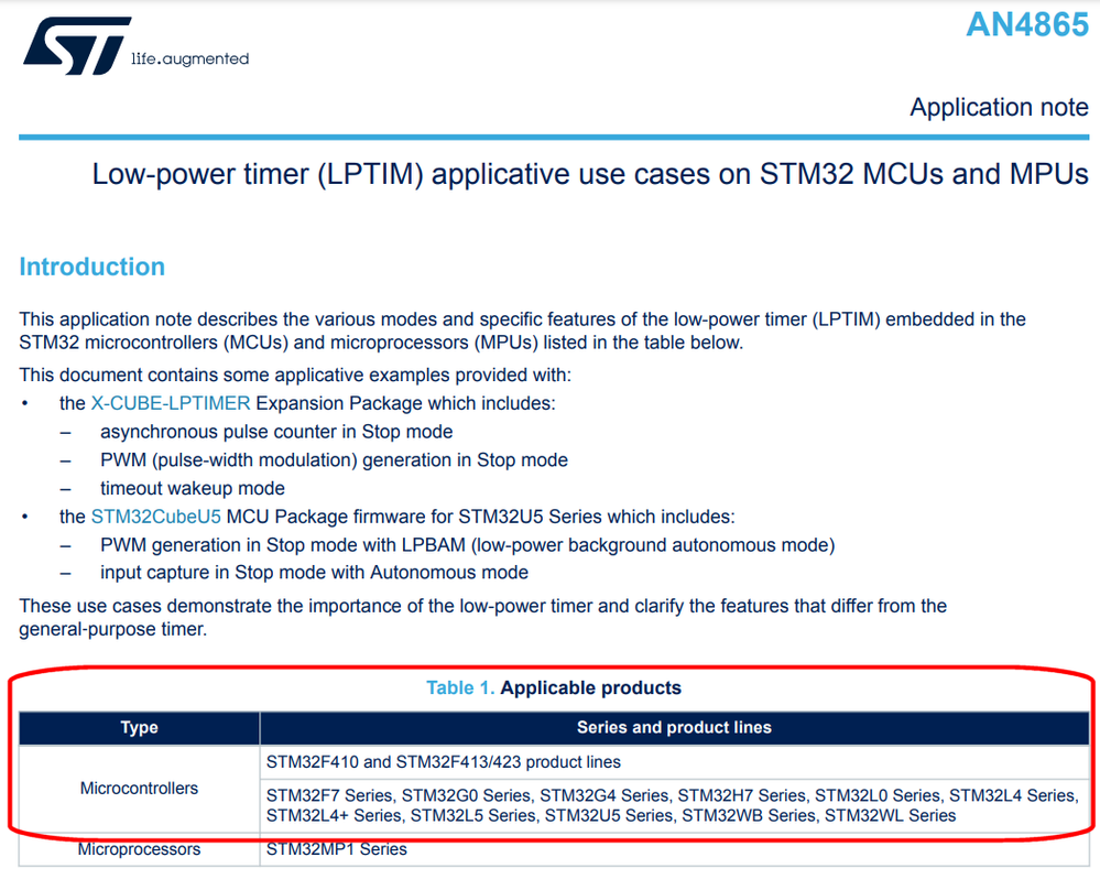

2024-04-17 2:42 AM
Chips which do have LPTIM:
So an L4 would be the closest to what you have ...
