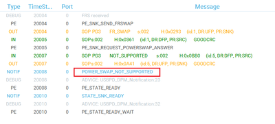

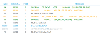

2024-12-10 12:47 AM - edited 2024-12-10 1:00 AM
Thank you very much for your reply. I have also carefully read the other article you provided.My DRP_Sink character sent an FR_Swap message, but DRP_Source does not support it.
The one above is DRP_Sink
The one above is DRP_Source

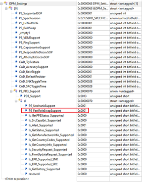

Did you check the definition of your PDO in usbpd_pdo_defs.h and in your usbpd_dpm_conf.h
2024-12-13 1:18 AM
Hello, I have checked the definition of PDO and it supports FRS. My code was directly generated using STM32CubeMX
