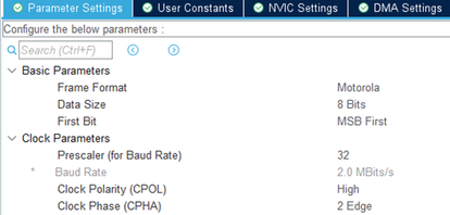

I am currently using the NUCLEO-H563ZI board to test SPI functionality.
I configured SPI1 as a master and was able to successfully transmit and receive data using HAL_SPI_TransmitReceive(). However, when I switched to SPI2, I found that the clock signal does not toggle at all, no matter what I try.
Is there anything specific that needs to be configured additionally for SPI2?
Below is my code; the rest was automatically generated by MX.
