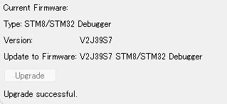

Have you upgrade the ST-LINK firmware uisng STM32CubeProgrammer or such? The tool should state the link type: Debug+MSC+VCP
hth
KnarfB
2022-08-02 11:34 PM
Yes.
Already upgraded.
