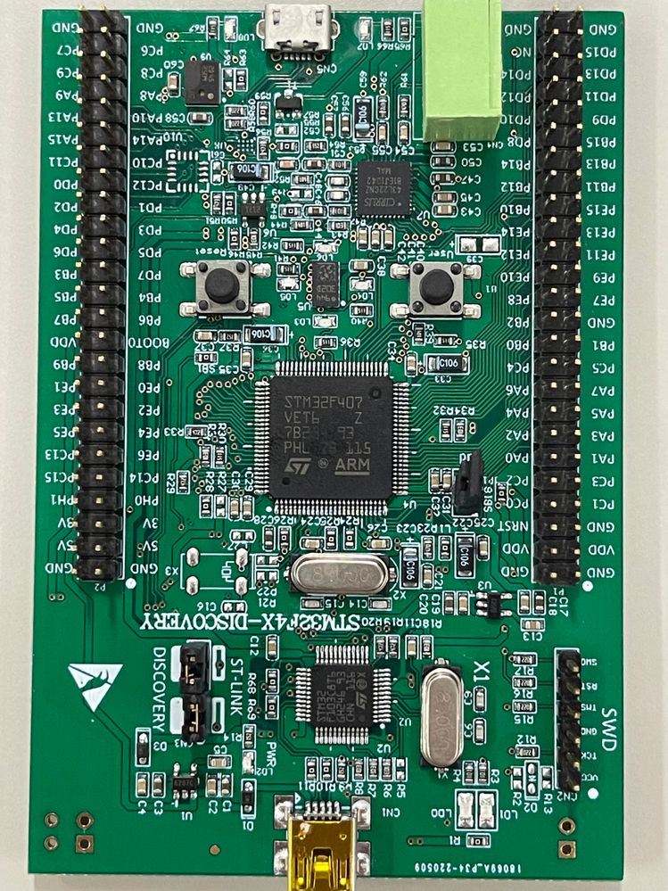

> I am using a STM407VET6 development board
What board? Post photo.
2022-08-02 11:01 PM
I'm using this board.
2022-08-02 11:07 PM
This board has a ST-LINK/V2-A which does not include VCP. See
STM32F4DISCOVERY Data brief and
TN1235 Overview of the ST-LINK versions.
hth
KnarfB
2022-08-02 11:10 PM
Can add VCP by soldering 2 wires, see UM1472 Discovery kit with STM32F407VG MCU
hth
KnarfB
