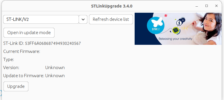

Continued:
and when I press the [OK] button I get the following window:
2022-12-11 1:23 AM
I do not really understand what this dialogue wants me to do - but whatever I click on nothing happens. Hard work ;-(
2022-12-11 1:30 AM
Unconnect and connect usb stlink, after this click open in update mode ... upgrade
